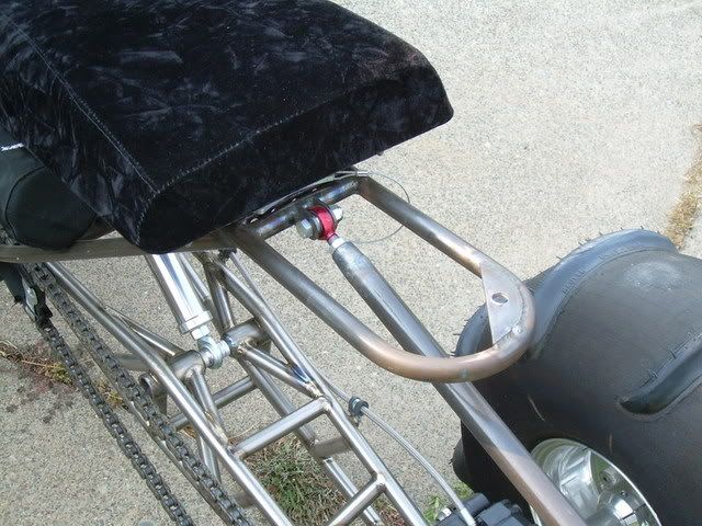

This is the one i made for my Honda... It would be simple to make one for a shee , maybe go off the grab bar mounts with duel top bars??? or if you wanted to weld a bar into the top like i did on my 250R you could run a single top...

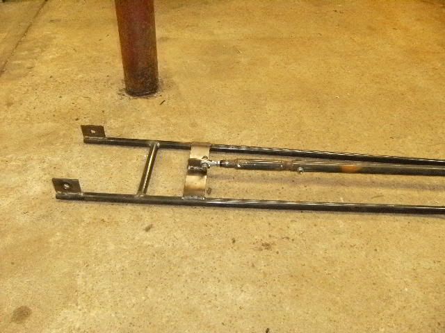

Rico...I'll get you pics of my setup as well.
I really gotta clean and paint my setup....
I finally got a chance to cut and customize my top inner/outer tube for the height adjustments I need. I can put it on the ground now....or 2 foot in the air within 20 or 30 seconds...very easily.
