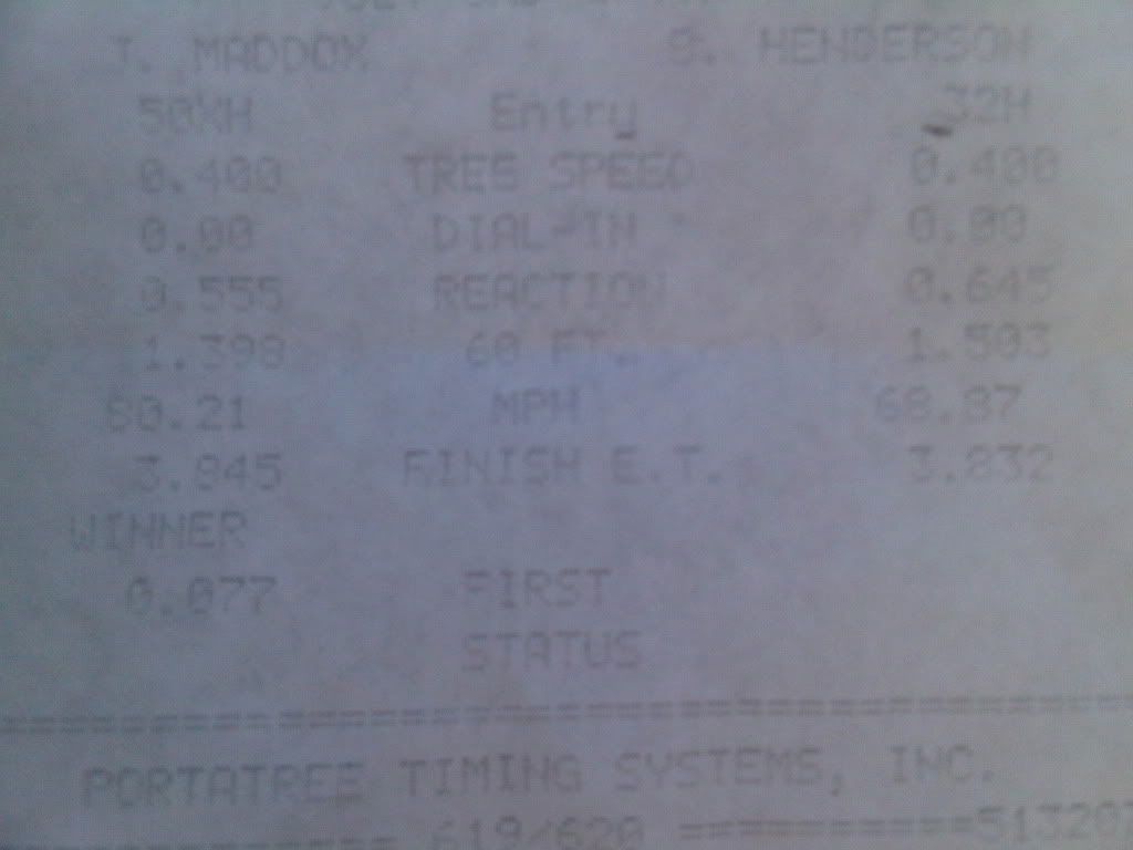

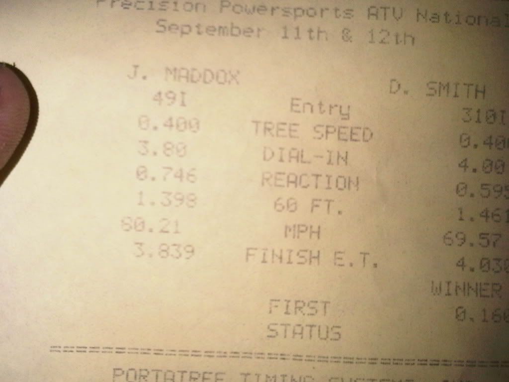

These cylinders were ordered from the builder knowing I intended to run the BB pipes. Your saying run the BBs? I guess I'll have to try both at the track and see which is better, but I'll have to calculate gearing for the 600 rpm peak difference. I won't name the builder; I think there is more in this motor. The domes were kinda jacked up. I had 200 psi and 180 psi in the left/right cylinders, respectively. The one with 200 had pitting when I took the head off, even though I never saw it on the plugs. The plugs are hard to read on the dyno, compared to the track. I have some new domes coming, I'll keep ya posted when I run it or dyno it again.

Good research, like you said...the track numbers don't lie.
