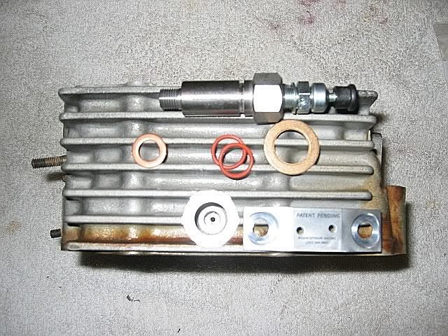

Hey check this out. I just got it from Jim Becica (BigDaddy660R). Manual decompression has been done before but this system requires no welding on the head or the timing gear. I had a piece of the stock decompression break off and fall down the timing chain last summer. I was lucky it did not completely destroy my head but I didn't want to take the chance again. The kit comes with a strap that replaces the stock decompression on the cam. It should start easy enough now I'm going to run a lighter YFZ battery.

QUOTE (SUBZERO @ Feb 1 2009, 02:31 PM) index.php?act=findpost&pid=28707Hey check this out. I just got it from Jim Becica (BigDaddy660R). Manual decompression has been done before but this system requires no welding on the head or the timing gear. I had a piece of the stock decompression break off and fall down the timing chain last summer. I was lucky it did not completely destroy my head but I didn't want to take the chance again. The kit comes with a strap that replaces the stock decompression on the cam. It should start easy enough now I'm going to run a lighter YFZ battery.
Thanks Jesse.........
I put the screws to mine yesterday, Hot Lapping my 720 on Roosterbuilts Dyno. It did GREAT. O and the motor ran good too........

Jim put one of these in my daughter's bike. I am very impressed! Thanks Jim.....

Oh yeah! Starts like it is supposed to now. Spits twice and it's idling....

I had Jim put one on my 812 and it works really well. The only trouble I have is the fact that my compression is through the roof and I have to hold the button in while cranking. I figured out that my bike will idle while I hold in the decomp button
Seriously though, I am extremely impressed and happy with the quality and fast turn around!
