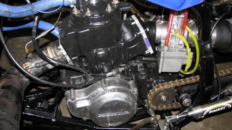

you would have to call mototassari for exact specifics, but i think they were designed for one of the CP cylinders (probly the puma but im not sure).
http://cgi.ebay.com/ebaymotors/HONDA-CR500...sQ5fAccessories
heres a link for them on ebay, they say theyre for a cr500, they do have the same bolt pattern but the intake hole on the manifold isnt exactly the same as the hole in the insert, so alittle grinding on the insert is required. i heard that mototassari was working on a insert specifically designed for a cr500 manifold

Yeah, the case savers get a little thin with a fifteen. A seventeen tooth and you have to grind and use a little epoxy so the oil won't seep out, lol. That looks like my intake boot. But I've got a little bigger carb in it than the 48. A real tight fit.
Josh, you might as well put a bigger sprocket on. Unless you've got some real big tires. What size tires are you going to run? I ran a fifteen on my 270 with 12 paddle extremes. I haven't had a chance to get mine out yet to see what gearing I'm going to run. I'm going to start with a fifteen(16 tooth's on backorder, since Nov 8th) with a 37 on the back. I'm starting with 72" 14 paddle extremes. If I blow them out I'll put the 80" 16's on, lol.
