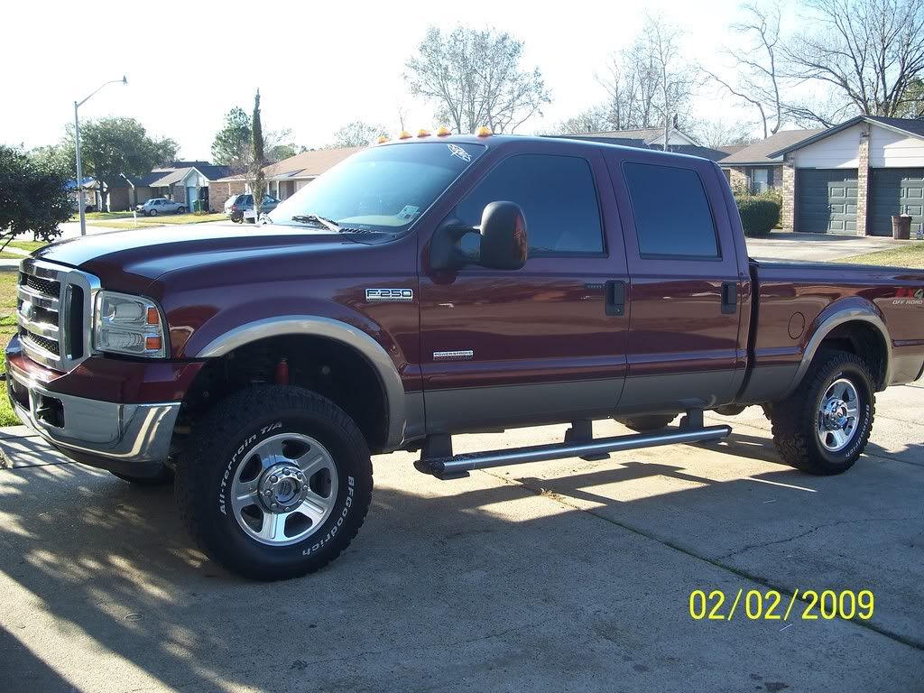

heres the whip guys. just thought id share. im getting some 41" iroks on 20" devino chomps and 10" of lift soon..
its a 2006 F-250 FX4 Lariat, 4" MBRP full exhaust with 6" tip. Bully Dog intake system, and thanks to Dylan some 305/65/18 BF Goodrich ATs

Nice truck man....Do you really like the iroks? I think they look a little goofy.haha....I would go with a 5 in with a 6 in tip or a 4 in with a 5 in tip cuz 4 in with 6 in tip looks linda weird. I dont know what size iroks come in but mine are 40/15.5/22 and i would never have that wide of a tire without fender flares. Cant wait to see the finished product. What chip you have?

I agree...too little of a pipe and to big of a tip. I would say stack it or dump it. Just buy a a 5in turbo downtube and an elbow with two or so feet then put a turn down tip on it. A lotta turbo whistle then.

The 5" down pipe will actually hurt you on performance and power, you need some backpressure to build boost. This is especially true with the 6.0L The most performance is a 3 3/4 or 4" downpipe to the factory cat location (no cat) and then 4 or 5" pipe with a glasspack style muffler. But stacks look cool as hell.
